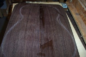

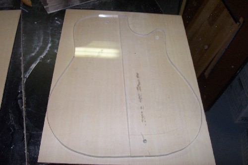

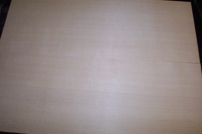

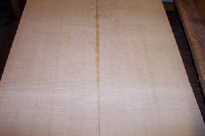

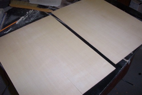

My # 2and # 3 are officially started, i joined the plates last week with HHG and it went rather well except for me being messy

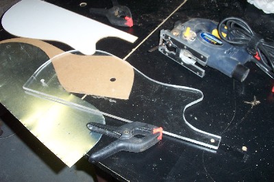

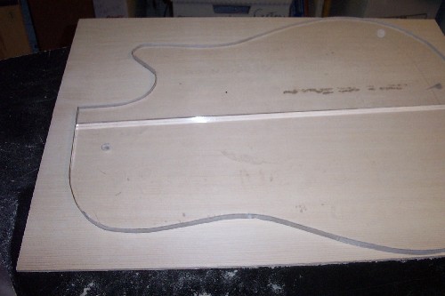

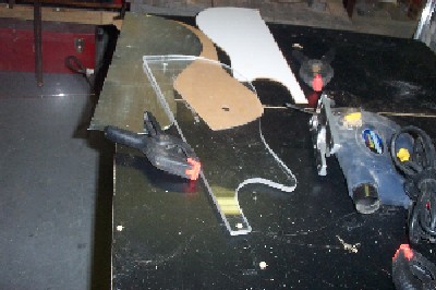

I also made some templates out of a piece of plexiglass that a friend gave me

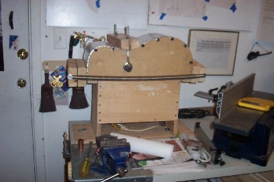

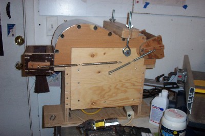

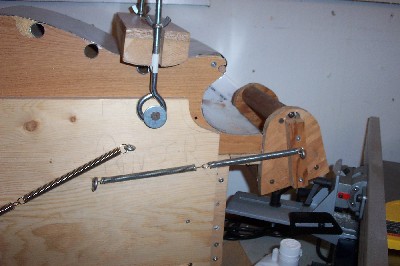

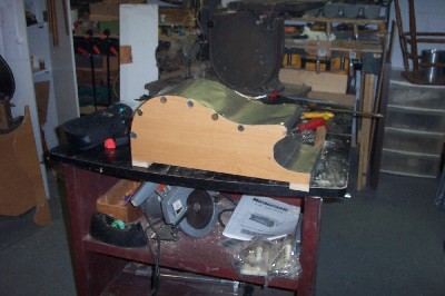

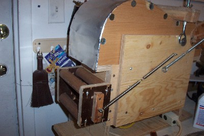

I also finished my side bender, inspired by Jc Jones, Bruce Dickey and Lance's bender so i have a mix of bending ideas. It's still a bender, not a blender ok!

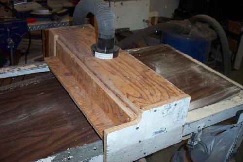

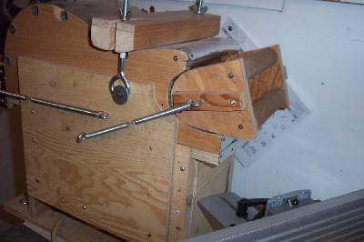

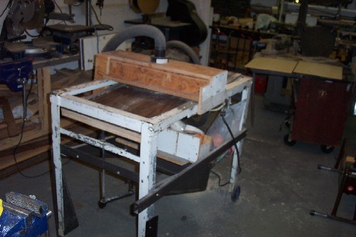

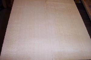

Last night i thicknessed my tops in preparation for my rosettes and my drum sander was up to the task and made me really proud, 1/4 turn on the lever and just a fine hair was taken off at a time!
My sander in action with the dust port!

It looks from here like that is a pretty tight cutaway you have going on. Make sure you thin the cutaway portion more than the rest of the side so that it will bend easily. I think the rosewood will probably be able to make that bend, but I wonder about some other woods.
I have no experience with machine bending so I can't really comment on how it might work.
Let us know how it goes eh!?!
Josh

Got any more info on that homemade drum sander??

Hesh, thanks, yes it's a Dread(sorry for swearing ) shape from my old 1981 IBANEZ, the cutaway design was added from me, just thought it looked so (getting addicted to that lil fellow too )and Yep, i'm the proud Daddy of my home made drum sander, thankfully, there was a lot of info out there on how to make them and i have access to lots o junk to build quite a few things! Very dusty tho!

Hi Colby, the iron table was given by my brother Martin, the motor is 1/2 hp, bought from an old pal for 50 bucks and runs at 1725 which is plenty enuff for this. At first, i did like most do ie a drum made with glued discs of 3/4" plywood but it was too heavy for 1/2" shaft so i thought of using 3" ABS PIPE which is already trued and inserted 2 small discs of ply at each end of the ABS drum and drilled 2 center holes 1/2" for the shaft to go through the drum and get to the 1/2" pillow block bearings. The motor is suspended on a springed table for pression on the belt and the plate on which i feed my wood is hinged on one corner of the sander.
The mechanism for lifting or lowering the feed table is very simple, it's just a 1/2" threaded rod going through 2 bars with welded nuts( welded by my pal Jacques) and i added a metal plate under the table so the threaded rod did not damage it. the drum allows me to 18" to sand, it's good enuff for me now but would go for 24" min. if i were to do it again!

Along with thinning the side in the cutaway, make sure you have good heat there and GOOOOO SLOOOOOWWWWW when bending it, just hand pressure (wear a good heat resistant glove) and realy let the wood form round that bend, I'm assuming you will be using your heat blanket and steel slats (can't remember if you have the SS or the spring steel), those slats will help support the wood on the outside of the bend.
#2 and # 3 well on there way. Great job.

That is a very ambious curve you got going there!
I would probably thin that down to about .060 where the apex of the curve is, and even then, luck MUST be on your side to get that done.
When I designed my cutaway models I used the cap from a can of spray paint to find the curve.
Im not saying that yours wont work, because it very will may.

Thanks for the tip Lance, i'm also considering adding a hot pipe to my arsenal of jigs and tools to achieve this bending.I might also order some practice wood for bending that kind of cutaway and see how it goes.

Way to go, Serge! Your bender is set up alot like mine, just don`t have the cutaway, though. Glad to see you`re making progress

Nice work all around. The template has a pretty aggresive cut away profile. Let us know how the bending goes. Or is it Blending?

CHARGE!!!!! Man you ARE at it! I think everything looks tremendous also. But please do try some practice wood on that curve before you bend a matched set. I think it is a pretty tight bend but when you are successful at it it will be your trade mark!

Looks good! You're obviously an ambitious guy. Thet cutaway is going to be a tough bend. Let us know how different woods behave on it for you.

Hey Serge, I was taking a second look at your pics and noticed this
That's not a gap is it? I'm hopeing that it's just a thick pencil line and not a gap or the plates separating. Please check it out, I would hate for you to route your rosette channel than have to pull the plates apart and re-shoot and join them.

Thanks kevin, after discussing with another member here, i changed my mind regarding that severe cutaway, i'll be going back to the drawing board for a less severe one, it'll only be a short delay but really worth the extra time to save my EIR from crackin'open!
